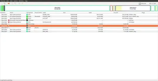

Below is the layout of my partitions. Ideally, I would reduce the size of the home partition, and increase the size of the root partition.

gparted results

If you have a Ubuntu LiveUSB you can use gparted for this.
Step one is to log in to the existing Ubuntu partition and use something like unetbootin to create your USB install.
Once that is done, reboot the system into the LiveUSB version. From there you can use gparted.
(EDIT: I completely forgot that you can’t affect the system you have mounted and are logged into. You need to switch out of that first; hence the LiveUSB.).
You will find gparted under the system tools or by clicking on the icon at the top. You can also start it by typing “sudo gparted” in the terminal (ctrl-alt-t). Type in your password when it asks (you won’t see anything happen when you type) and hit enter.
But back up your info just in case BEFORE YOU BEGIN.
Because you are dual-booting, make sure you are working on the correct partition. You don’t want to crash the working one.
