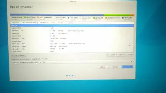

And my partitions system is the following:
I re-installed Xubuntu but the Grub-rescue messaged kept showing. I cannot boot on Xubunto anymore (but from USB LIve).
What should I try next? Is there any way to fix this from windows 10? Any clue on how to delete everything regarding to Xubuntu and start fresh?
