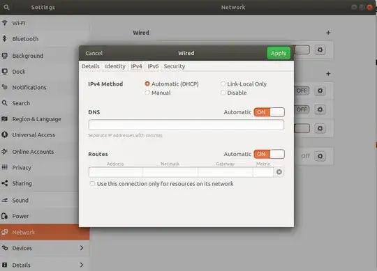

Is there a way to prevent my system from using the regular internet and only restrict it to using a VPN only on Ubuntu 17? FYI, I already setup protonvpn via the .ovpn files and currently just connect to it by turning it on with the dropdown in the menu.
I want to force all connections to only use VPN, and if the vpn isn't accessible, it should prevent all types of connections to the internet.
I know it has something to do with setting the routes on the IPv4 section, but I'm not sure what.

You can prevent the system from accessing the network when not on VPN by editing the interface configuration, either in /etc/network/interfaces or (more likely if you are using a desktop system) from the NetworkManager. Open the NM, select "configure networks" or some such, then edit the options for how each interface gets its address to have static routes that do not include a default route (or add a default route to blackhole). Then set up your VPN to give you a default route via that when it comes up.
Without more details about your setup, this is about as much as I can say.
