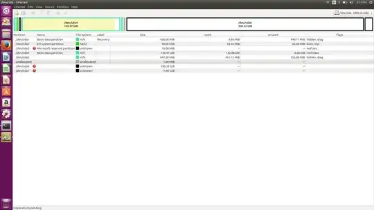

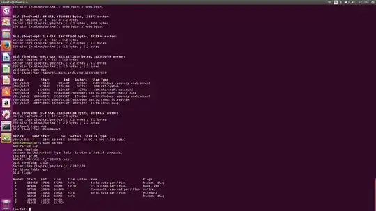

Here are the summaries give by fdisk, parted, and gparted, but I don't really know what to make of them other than that they appear to disagree about the size of my Ubuntu partition, and that only fdisk appears to recognizes the Ubuntu partition.
Parted and fdisk -l results
gparted screen shot
