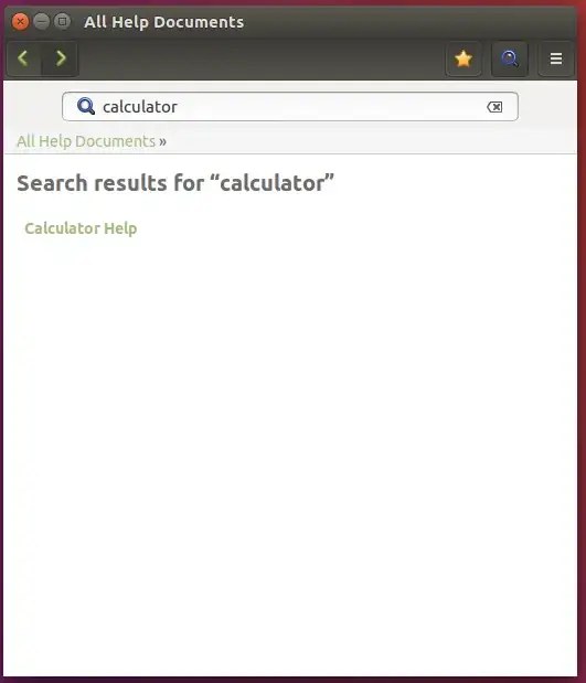

    After installation you can test patched version of Yelp. Launch it, navigate to All Help, press Ctrl+S and enter for example calculator and press Enter:
    patched Yelp with search
    But it seems that search works only in titles, not in full text.
