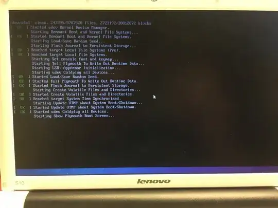

After recently updating my Lubuntu install (on an old (>10 years) netbook), the desktop no longer loads. After showing the standard terminal checks, the taskbar will usually load, but the rest of the desktop won't. THe taskbar will update as well. For example, if I turn off wifi, the taskbar will show I am no longer connected. If I quit dropbox, the taskbar removes that icon. I can still use the computer in the terminal with ctrl+alt+F1, etc., but the desktop won't load.
Any ideas how I can fix this, what to look for, etc.? I'd like to avoid a reinstall if possible, mostly because I'd prefer to learn something since this isn't my main machine. Also, if the update broke something, a reinstall won't help much.
Desktop Usually the taskbar loads correctly (with "start" menu, status icons, etc.). It stopped doing so after a little troubleshooting.

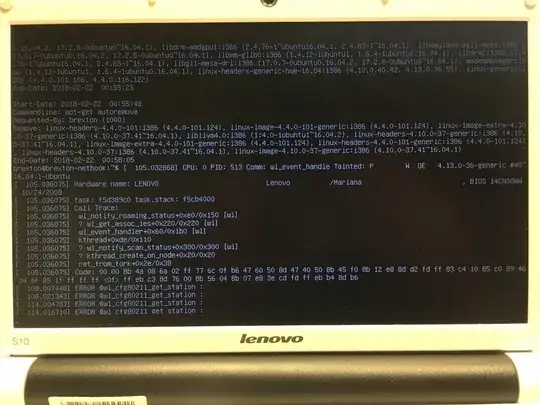

Additionally, this message has been popping up occasionally: Error message. I'm not sure if it's related at all.
