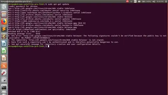

This is what appears when I try sudo apt-get update:

When I faced this issue on my system, I did an extensive search on Google. Post some good research, I figured out that google-chrome-stable is available via a 3rd party repository link.
Installation can be completed in just 3 steps as follows:
  • Add the key using;
wget -q -O - https://dl-ssl.google.com/linux/linux_signing_key.pub | sudo apt-key add -
  • Set the repository:
echo 'deb [arch=amd64] http://dl.google.com/linux/chrome/deb/ stable main' | sudo tee /etc/apt/sources.list.d/google-chrome.list
  • Perform the final update & installation using the commands:
sudo apt-get update sudo apt-get install google-chrome-stable
This worked for me even on v16.04 LTS, so I am hopeful that it should work for you as well.
