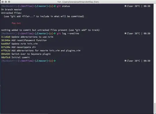

Simple question, I'd like to remove the time stamp on the right hand side of the fish shell terminal screen:
On a sidenote, it would be even better to know how to customize it as in the image below:
Put this in your config.fish (or eg. .config/fish/functions/fish_right_prompt.fish):
function fish_right_prompt
#intentionally left blank
end
By putting stuff in this function you can also customize that part of the prompt however you want to. Whatever is returned by this function becomes the prompt.
