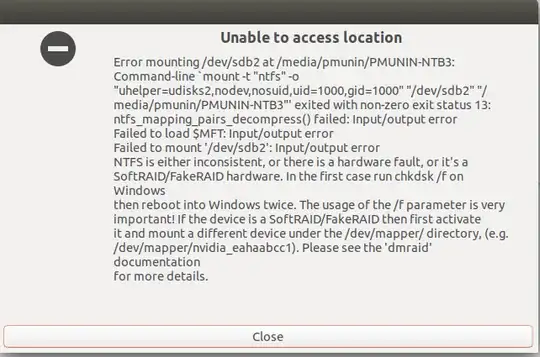

When I try to mount this partition under Ubuntu - it shows error message: enter image description here

sudo ntfsfix /dev/sdb2
Mounting volume... ntfs_mapping_pairs_decompress() failed: Input/output error
Failed to load $MFT: Input/output error
FAILED
Attempting to correct errors... ntfs_mapping_pairs_decompress() failed: Input/output error
FAILED
Failed to startup volume: Input/output error
Checking for self-located MFT segment... OK
Unrecoverable error
Volume is corrupt. You should run chkdsk.
