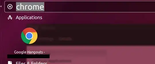

I am running Ubuntu 16.04 LTS and am having a persistent, obnoxious problem with Chrome and Hangouts. If I attach a Chrome shortcut to the launcher and/or search for Chrome, it insists that it is Hangouts (I use the Hangouts extension in Chrome), and does not give me options that I need to use (web developer), namely "Launch Incognito." Screenshot of what comes up when I search "chrome" in Applications:
chrome is hangouts

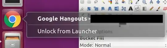

Similarly, if I add a shortcut to Launcher (via drag/drop from the search) and then hover, this shows:
chrome launcher hover
If I right-click the icon in the Launcher, I don't get any of the usual options for launching Chrome in Incognito mode, etc.:

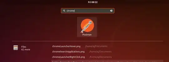

I've upgraded to 18.04 LTS and this problem persists. I just completely uninstalled Chrome, reinstalled it (from the .deb package), and when I attempt to launch Chrome from the new Activities thinger, this madness occurs:
Postman is an app I use for HTTP testing. It was originally a Chrome extension and then I installed it as a native application. I have searched my system high and low for any references to it and have removed them, but this problem STILL persists.
