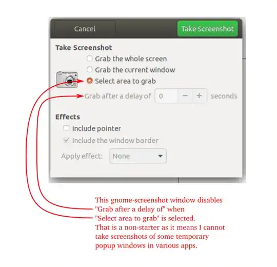

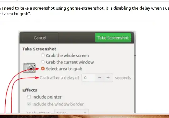

When I need to take a screenshot using gnome-screenshot, it is disabling the delay when I use "Select area to grab".
Is there any way to fix this defect? Is it a defect or is it by design, and if so, why?

  • It seems that GNOME developers removed this functionality from gnome-screenshot - it does not work on 14.04 LTS, 16.04 LTS, 17.10 and 18.04 LTS) - I reported:
    1. bug 1751161 to launchpad about disabled "Grab after a delay of..." in
      gnome-screenshot -i
    2. bug 1751157 to launchpad about option conflict in
      gnome-screeshot --area --delay 10
  • On 16.04 LTS you can use mate-screenshot - it has delay in GUI (launched by mate-screenshot -i -a) and in terminal:
    mate-screenshot --area --delay 10
    but it is really ignored.
    In 16.04 LTS, 17.10 and 18.04 LTS delay is disabled when mate-screenshot ran interactively (mate-screenshot -i) - reported bug 1751245 to launchpad about this.
    In 17.10 and 18.04 LTS it works only from terminal - so I reported bug 1751141 to launchpad.
