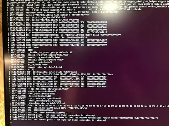

I just installed 16.04 LTS on my new desktop, Dell Alienware Aurora R7, with i7-8700K, 32GB RAM, SSD(SM961 NVMe SSD) and 1080TI.
So far, everything works ok except I get a kernel panic when I try to shutdown (reboot works ok).
How can I avoid that?

I have an Alienware Aurora R7/0VDT73, BIOS 1.0.11. The system crashed on shutdown because of IRQ issues on a built-in-module (i2c-designware-core).
I solved this by editing the file /etc/default/grub and adding the kernel option noapic, to this line:
GRUB_CMDLINE_LINUX_DEFAULT="quiet noapic splash"
After that you should also launch the command:
sudo update-grub
Now my system shuts down without any problem.
How I solved this issue!
Add initcall_blacklist=dw_i2c_init_driver to the kernel command line. This works for me on kernel 4.15.0+.
For anyone else who'll find this answer. You can do it by editing /etc/default/grub:
Run in the terminal: sudo -H gedit /etc/default/grub.
(if you don't have gedit installed use your favorite text editor or "sudo apt install gedit" without quotes)
Append blacklist string to the GRUB_CMDLINE_LINUX_DEFAULT: GRUB_CMDLINE_LINUX_DEFAULT="quiet initcall_blacklist=dw_i2c_init_driver".
Save the file, close the editor.
Run in the terminal: sudo update-grub.
Reboot and test!
Credit goes to this post: https://unix.stackexchange.com/questions/423797/how-do-i-disable-i2c-designware-support-when-its-not-built-as-a-module/446913#446913
