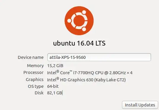

I am trying to install some drivers on my new laptop (Dell xps 5). This is my current ubuntu version:

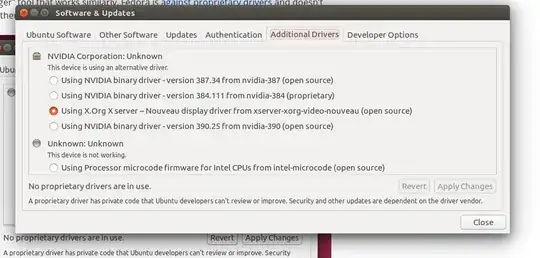

This is my current driver:

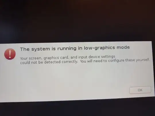

and when I changed into one of the nvidia drivers, I get this when I restart my laptop:
And I am stuck there I cannot pressed the OK button, even if its there. So I power off my laptop and start it again and choose one of the generic modes
to start Ubuntu again. Is there an application or smth which search and install your drivers for Ubuntu, like SlimDriver for Windows ? Or do you other idea how to fix this ? Thank you!

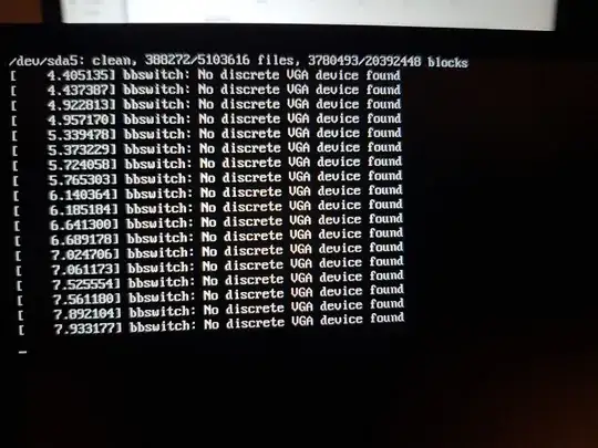

[UPDATE]
After I installed the Intel Graphics I tried to install one of the nvidia drivers and I get this when I restarted my laptop:
But this issue was fixed: Fast-pressed key triggers auto-repeat (Ubuntu 14.04 LTS)
