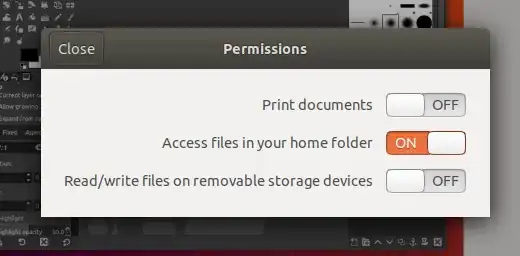

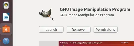

The Ubuntu Software program now has a way to set permissions on the page for the snap software with this issue. There is a 'Permissions' button under the name of the program.
The page for GIMP in the Ubuntu Software program, showing the Launch, Remove, and Permissions buttons
Click that, and then click the button next to where it says 'Read/write files on removable storage devices'
You will be prompted to enter your password. After that the problem is solved.
Ubuntu will regard internal drives other than the drive with the Ubuntu OS as removable storage devices too.
