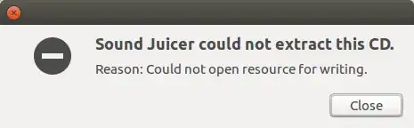

After hitting extract:
"Could not open device for writing"
But I am able to write other files from this disk. And from other disks, so why this file?
Hitting "Close":
error starting ripping pipeline
So, possibly data corruption? I've checked the disk, and it appears pristine.

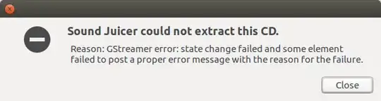

Close again:
GStreamer error: state change failed and some element failed to post a proper error message with the reason for the failure.
None of the results at a Google search for this string and sound-juicer are relevant. are useful.
How would I go about making it possible to debug this usefully?
