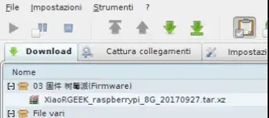

After upgrading from 17.04 to 17.10, and consequent switch from Unity to Gnome Shell, all the menus of JDownloader 2 became unclickable.
By "unclickable" I don't mean disabled, but that I cannot click them with the mouse.
The menu opens when I press the mouse button and closes when I release it. So I can keep the menu open by long pressing it but, even when open, the items are not clickable.
This happens with all the menus, like the usual Drop-down main menu or the right click menu.
With the right click menu, it stays open when I right click but I cannot select any entry with the mouse because the focus is on the back.
