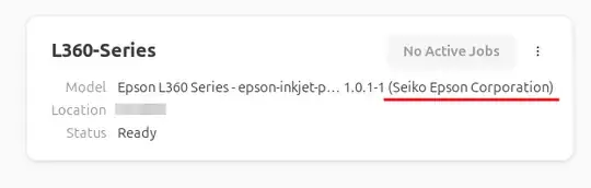

  4. Reinstall the printer in Settings. Go to Settings > Printers, remove the installed one and Add Printer...
You should see something like this, note that the driver was provided proprietary by Seiko Epson: Installed Epson L360 printer
This was tested on Ubuntu 24.04.
