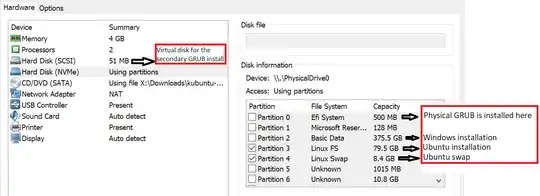

From Windows 10, I now want to boot the Ubuntu install, so I created a "virtual" NVMe disk in VMWare Workstation that uses the physical Ubuntu EXT4 partition + the swap partition.
The problem is that the system does not boot as there is no bootloader.
So I created a proper virtual disk in VMWare where I was planning to install another GRUB instance (from a Live CD) to start the Ubuntu installation. The problem is that GRUB wants me to chroot to the existing install, while all I want is just to install another GRUB on the virtual disk.
Here is the VM configuration, the ticked boxes are the partitions used in VMWare Workstation.
Is this the correct way to proceed? What do I have to do to continue?
