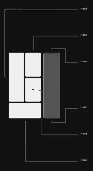

I'm using Ubuntu 17.10 with Gnome Shell and a Wacom Intuos 3. The tablet has a vertical touch strip on either side and I would like to use these for vertical scrolling.
xsetwacom reports that these strips are both configured by default to send vertical mouse scroll button signals:

But the GUI system settings for the Wacom tablet show that the buttons are configured to have no effect. My understanding is that some piece of software is swallowing the mouse scroll signals coming from the tablet and not passing them to the system.

What can I do to stop the system from intercepting scroll signals or send them by other means using these touch strips?
To stop gnome from intercepting Wacom pad events you could try this:
  1. Switch to Xorg
  2. Run dconf-editor
  3. navigate to org.gnome.settings-daemon.plugins.gsdwacom
  4. set this value to false
