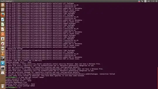

I tried to install xdman using
sudo add-apt-repository ppa:noobslab/apps
sudo apt-get update
sudo apt-get install xdman
but I can't download it; I get this:
E: Could not get lock /var/lib/dpkg/lock - open (11: Resource temporarily unavailable)
E: Unable to lock the administration directory (/var/lib/dpkg/), is another process using it?
I get the same error if I try to install anything else.
After resolving that, I now get the error
E: unable to locate package xdman
this is the new error I got
