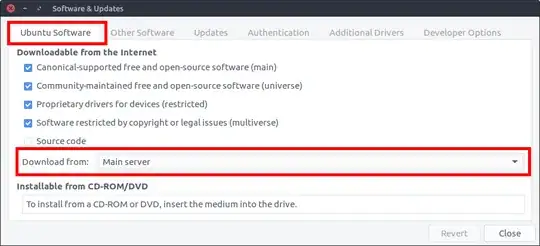

Edit 1
To change the download server, kindly search in dash for 'Software & Updates' and open it. On the first tab, in the section 'Download from' kindly select the main server if another is selected.
See screenshot below:
