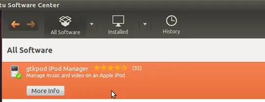

First install the gtkpod iPod Manager (Install link) in the Software Center.
Screenshot of the software center

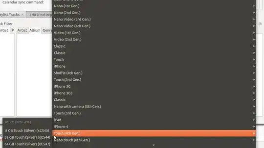

As you can see when starting the program it has on its list the 4 Gen of Touch:
Screenshot of gtkpod
Also checked with latest Shuffle and works. The only one that works actually.
If a user uses Banshee or even Rhythmbox they will hear a woman in the Ipod saying that you need to sync it with itunes. The only one I have known that correctly syncs is gtkpod.
