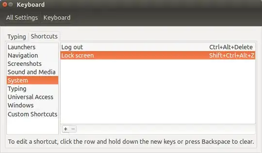

Disable Ctrl+Alt+T in Ubuntu shortcuts
Go to System Settings -> Keyboard -> Shortcuts -> System -> Lock Screen and hold down Ctrl+Alt+Shift+Z
This will hopefully allow you to reassign the original key combination in another application.
