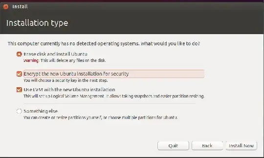

Before I knew this was the cause, I tried solving this by installing a fresh copy of Ubuntu. Interestingly, unless I selected the following install options I would run into the same problem:
Why in the world would leaving Encrypt... and/or Use LVM unchecked cause major lag?
