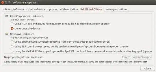

I had been experiencing the same problem with my Dell Vostro 5370 and Ubuntu 16.04 LTS.
This is how I solved it:
  1. Go to "Software & Updates" application
  2. Under "Additional Drivers" tab, you should find "Intel Corporation: Unknown" section.
  3. Choose "Do not use the device"
Do not use DKMS driver from oem
Because DKMS will "pollute" your kernel until you purge the kernel using apt-get. The way I did is:
