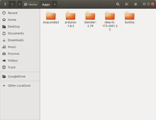

I want to enter the folder "Anaconda3" from here.
file browser

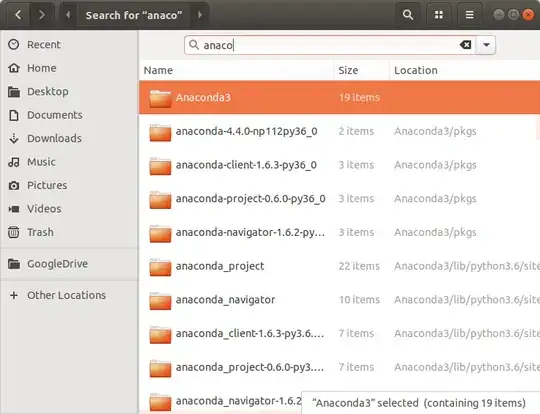

So I start typing "anaco" and as I type, search results are changing quite frantically as the search criteria changes.
search results

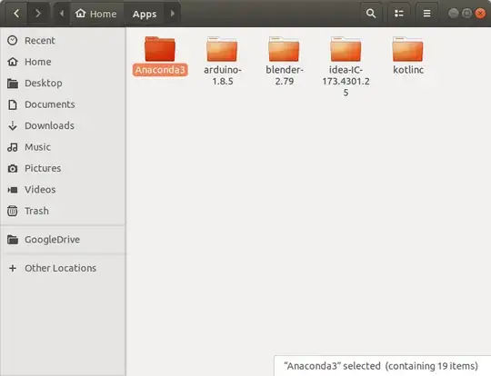

This is not what I want the file browser to do. I just want to select the "Anaconda3" folder, like so:
folder selected
