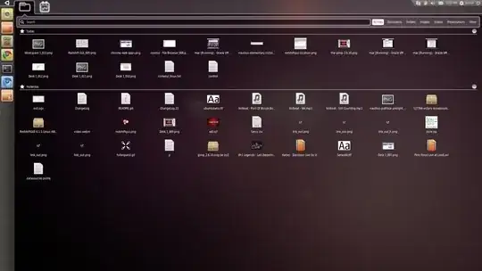

Unity netbook interface:
alt text
The interface for the desktop is currently being discussed: Launchpad Blueprint
