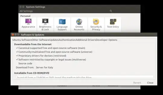

After installing the Evolution and Geary e-mail clients, Ubuntu desktop and application GUIs are messed up. See screenshot below for an example; as you can see, tabs are not separated anymore, and buttons (Revert, Close) are not drawn.
How can I restore the previous desktop/GUI appearance, without re-installing Ubuntu?

Screenshot
