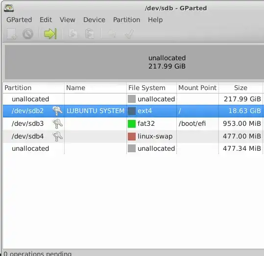

I need more space on my root partition running Ubuntu 17 (using Xfce session).
I do have a lot of unallocated space BEFORE.
However, when I try to resize root partition - /dev/sdb2 , I can't add/remove a MiB...
Is this even possible?
If so, can it somehow be done from the live system or do I have to use live CD/USB?
There is really just Ubuntu and Xcfe session, LUBUNTU_SYSTEM is just an old label :)

A partition can only be resized by modifying its end. Therefore first, you have to move the / partition to the beginning of the drive, gaining some free space after the moved / partition. Then you can grow the / partition which will be done by changing its end block number to a bigger number.
These actions can both be made through GParted, called from a live system on an USB or a DVD, but not from the current system where the partition is currently mounted.
