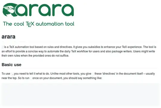

Also, this cool github page appears like this:
