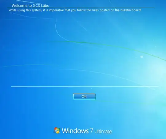

I'm new on Desktop Engineering and i'm working on a project customizing a Ubuntu. I would like to know how to create a Warning before login that looks like the image below for Windows. I've been searching a lot and I didn't find something really helpful.
Thanks in advance.
Example on Windows
