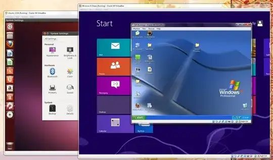

You can do it on your own current operating system.
Use Virtual machines (Virtual Box is good) and install any number of machines(which are called guests). Try them, test them out without harming the stability of your main system(which is the host).
Most virtualization software is available for Linux as well as Windows hosts.
Hope that's a better solution than a cloud service. Most people use virtualization to accomplish testing and trying.
