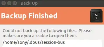

What are /home/user/.cache/dconf and /home/user/.dbus? Why does their backup fail?
I tried following this 2013 answer (see code below) but while it allowed me to backup the above files, now I am told it couldn't backup /home/[user]/.dbus/session-bus.
deja-dup backup GUI reports inability to backup .dbus/session-bus

I had the same problem:
  • ~/.dbus was failing at being backed up, and
  • it was belonging to root:root
Thanks to this answer, I've deleted ~/.dbus, restarted, and run the Backup again.
The Backup is now fully working!
Note 1: the .dbus folder it's not been recreated yet, but it should be when needed (hopefully with the appropriate myuser:myuser permissions).
