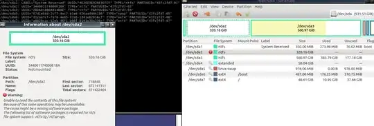

I logged into Lubuntu after 3 months of inactivity and ran sudo apt-get update and sudo apt-get upgrade . I am unable to see Windows on startup, only Ubuntu and other recovery options for Linux are available. Moreover I checked in BIOS about UEFI. It's all fine. I am unable to mount. GParted shows Windows not mounted and lsblk looks like this:
gparted shows windows not mounted and lsblk looks like this

Thank you very much for sparing your time to answer my question. My problem got solved after I installed boot-repair and gave recommended actions.
I reinstalled and now I can see windows back.
