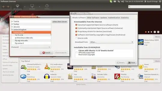

Open Software Center > Edit > Software Sources.. > then from Ubuntu Software (tab) > (Check ) Download From > { Change the Server }
Have you checked which server you are downloading from ? Try switching to main, i just recently had the same problem with the canadian server.
