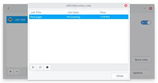

Printers settings
But when I want to print the job hang on Processing:
Print job hang on Processing

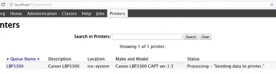

I went to the http://localhost:631/printers/ and it shows Processing - "Sending data to printer."

Canon would say you need to do 4 things for the CAPT driver in linux
1) install drivers
2) Register the printer (PPD) with the print spooler.
3) Register the printer in the ccpd daemon setup file.
4) start up ccpd daemon
1) get the latest drivers from here http://support-asia.canon-asia.com/contents/ASIA/EN/0100459601.html and click to download and save linux-capt-drv-v271-uken.tar.gz
2) sudo /usr/sbin/lpadmin -p LBP3300 -m CNCUPSLBP3300CAPTK.ppd -v ccp://localhost:59787 –E .....note this is all one line ......
3)sudo /usr/sbin/ccpdadmin -p LBP3300 -o /dev/usb/lp0 and that assumes only one usb printer
4) sudo /etc/init.d/ccpd start
and for me that has worked on two separate 16.04 installs
