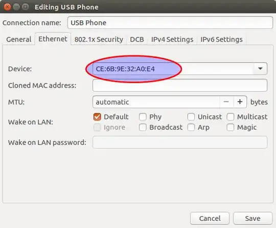

First, find the MAC address of the USB port you will use
Connect your phone to your PC using an USB cable.
  1. Turn USB tethering on in your phone. This will use your phone's mobile data to connect the PC to the Internet. This is not what we want, but this will give us the device address we will use later.
  2. Open the Network Manager edit window from the Network icon on the top right corner.
  3. Highlight the USB connection. It may be called Ethernet Connection 1 or Ethernet Connection 2.
  4. Click on the Edit button and go to the Ethernet tab.
  5. Copy the information in the Device field: enter image description here
  6. Press cancel button to get out of the Network Edit menu. Do not close the Network Connections window yet.
  7. In your phone turn off USB tethering.

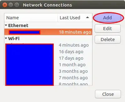

Second, setup a new network connection
  1. Click Add in network connections:
  2. Give the new connection a new name if you want.
  3. Go to the Ethernet tab and paste the device information you copied.
  4. Go to the IPv4 Settings tab and select Shared to other computers: enter image description here
  5. Save and close network connection windows.
