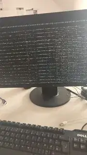

I am trying to install Ubuntu Server 17.10 on a new Lenovo P920 Workstation with a Samsung NVMe SSD hard disk drive. I tried Debian 9.3 first, but that did not recognize the SSD; Next try goes to Ubuntu Server 17.10 because I figured I try the most recent kernel I can easily get my hands on.
Unfortunately I do not get far - Grub works, but soon after grub the installer resets the graphics mode and I only get garbled text. I have experimented (i.e. edited the Grub command line) with different GFXMODE and GFXPAYLOAD settings, but they at most change the graphics directly after executing the grub command line (pressing F10 to boot) - then the Ubuntu installer resets the graphics mode (i guess?) and I get glitch art again.
  1. What else could I try to install Ubuntu Server?
  2. Can I find out whether the SSD is supported so I know if it even makes sense keep trying to work around the current graphics problem?
Ubuntu Server 17.10 Installer on Lenovo P920 Workstation
Adding nomodeset to the kernel command line did the trick! Thanks to http://www.rodsbooks.com/linux-uefi/ (via https://askubuntu.com/a/842916/249197)
It says:
Fixing blank displays—A problem that many people had through much of 2013 (but with decreasing frequency since then) was blank displays when booted in EFI mode. Sometimes this problem can be fixed by adding nomodeset to the kernel's command line. You can do this by typing e to open a simple text editor in GRUB. In many cases, though, you'll need to research this problem in more detail, because it often has more hardware-specific causes.
(btw, the SSD is supported in Ubuntu 17.10)
