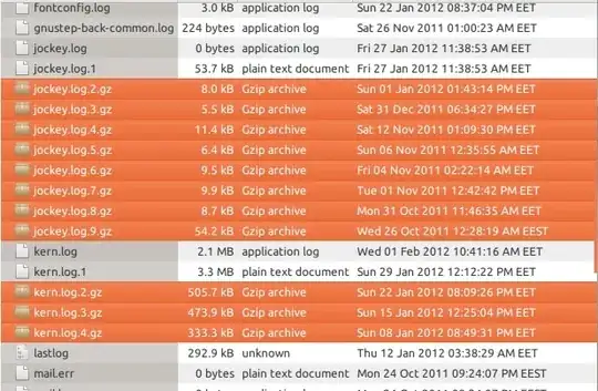

You must not remove the entire folder but you can remove "Old-Packed" log files without harming your system.
For a typical home user, it's safe to remove any log file that is compressed and has a .gz extension (as you can see in the picture).
These compressed log files are old logs that are gzipped to reduce storage space, and as an average user, you don't need them.
Select .gz extention
