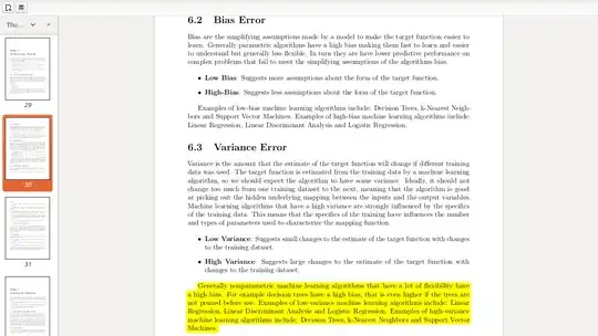

Some examples of low-variance machine learning algorithms include linear regression, linear discriminant analysis, and logistic regression.
Examples of high-variance machine learning algorithms include decision trees, k-nearest neighbors, and support vector machines.
Source:
What makes a machine learning algorithm a low variance one or a high variance one? For example, why do decision trees, k-NNs and SVMs have high variance?
