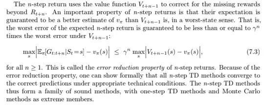

In section 7.1 (about the n-step bootstrapping) of the book Reinforcement Learning: An Introduction (2nd edition), by Andrew Barto and Richard S. Sutton, the authors write about what they call the "n-step return error reduction property":
But they don't prove it. I was thinking it should not be too hard but how can we show this? I was thinking of using the definition of n-step return (eq. 7.1 on previous page):
$$G_{t:t+n} = R_{t+1} + \gamma*R_{t+2} + ... + \gamma^{n-1}*R_{t+n} + \gamma^{n}*V_{t+n-1}(S_{t+n})$$
Because then this has the $V_{t+n-1}$ in it already. But in the definition above of the n-step return it uses $V_{t+n-1}(S_{t+n})$ but on the right side of the inequality (7.3) that we want to prove it is just little s $V_{t+n-1}(s)$ ? So kind of confused here which state s it is using? And then I guess after this probably pull out a $\gamma^{n}$ term or something, how should we go from here?
