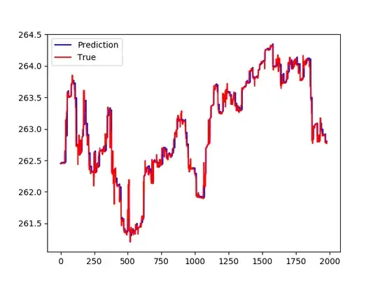

This is the result:
Predicting moving average:

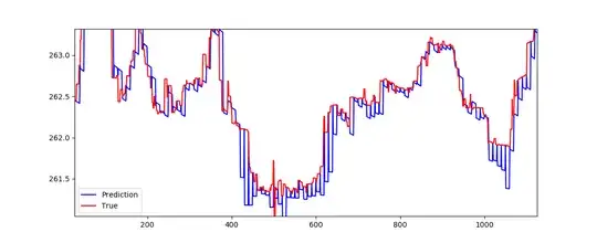

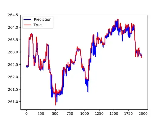

On closer inspection we can see what's going wrong:
Prediction seems to be a flat line. Does not care much about the input data:

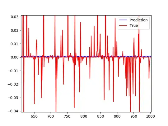

  1. The second attempt was trying to predict differences, instead of simply the price movement. The input this time instead of simply being X[t] (where X is my input matrix) would be X[t]-X[t-1]. This did not really help. The plot this time looks like this:
Predicting differences:
But on close inspection, when plotting the differences, the predictions are always basically 0.
