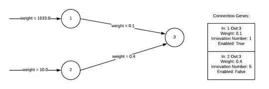

The disabled/enabled bit in a connection gene indicates whether or not it should be expressed in the calculation of the network.
Here's an example: enter image description here
This is a neural network and its corresponding connection genes which represent the layout of the network among other things. The top connection gene going from 1 -> 3 that has a weight of 0.1 is expressed in the calculation of the network. The bottom connection gene going from 2 -> 3 that has a weight of 0.4 is not expressed in the calculation of the network.
Calculating the network:
1633 * 0.1 = 163.3
Given the weights in the example the output of this network is 163.3
Hypothetically, if both connection genes had their enabled bit set to true (which can happen in the future, to quote the paper: "The disabled genes may become enabled again in future generations") then the output of the network would be:
(1633 * 0.1) + (10 * 0.4) = 167.3
To answer your question, the connection between two nodes still exists in the network regardless of whether the bit in the gene is enabled or disabled, but, if the bit in the gene is disabled it is not used when the output of the network is being calculated as I've shown above.
