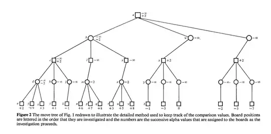

I was recently perusing the paper Some Studies in Machine Learning Using the Game of Checkers II--Recent Progress (A.L. Samuel, 1967), which is interesting historically.
I was looking at this figure, which involved Alpha-Beta pruning.
It occurred to me that the types of non-trivial, non-chance, perfect information, zero-sum, sequential, partisan games utilized (Chess, Checkers, Go) involve game states that cannot be precisely quantified. For instance, there is no way to ascribe an objective value to a piece in Chess, or any given board state. In some sense, the assignment of values is arbitrary, consisting of estimates.
