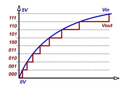

Finally: All NN's do is approximate a real valued function. You can try to magnify this function by multiplying it with a factor, but whenever you are switching from, real valued function to integers you are basically representing the function as a series of steps. Something like this happens (Image only for representation purposes): enter image description here
You can clearly see the problem here, each binary number represent a step, to have better accuracy you have to increase the binary steps within a given length, which in your problem will translate to having very high value of bounds [-INT_MAX, INT_MAX].
