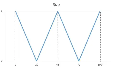

After i did a bit more study on this, i found this solution.
Membership Graph
μsmall[x]
  • 1; -> x≤0
  • (20-x)/(20-0); -> 0
  • 0; -> x≥20
μmedium[x]
  • 0; -> x≤20 or x≥70
  • (x-20)/(45-20); -> 20
  • (70-x)/(70-45); -> 45
μlarge[x]
  • 0; -> x≤70
  • (x-70)/(100-70); -> 70
  • 1; -> x≥100
For the final result i need to add 3 more rules for the function to work. So it become 9 rules and 3 variables, with 3 rules for each input variables.
To answer both of my question:
  1. Add a triangle graph and use the formula.
  2. Add a triangle graph for each rules.
What i learn from this is the total rules needed to determine the output is the number of input variables rules multiplied(i.e. v1 = 3 rules, v2 3 rules, total rules = 3x3=9 rules). And i'm not really sure about this one but you can combine multiple kind of graphs.
