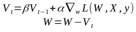

If you want only the answer to your question in particular, you can skip to the last part of the answer. To answer in detail momentum is a technically incorrect term, I would rather call it inertial learning.
Inertia - Inertia is the resistance of any physical object to any change in its position and state of motion.
First the equation of weight change in the momentum learning method at a particular iteration is given by the equation: enter image description here
Where beta will be the momentum term. If we expand the expression we get something like:
Courtsey: Stochastic Gradient Descent with momentum
Here S_t are the gradients or dels for a particular training example. Clearly this is for a 3 example training set.
Now why do we use momentum? As @Andreas Storvik Strauman has provided a link, you can easily delve into the mathematics for its usage. But to make a more intuitive sensehere are a few points to note:
  • The exponentially weighted terms can be thought of as past memory of what you learned. You don't want to forget it completely, so you keep on revising it with weight-age of revising it decreasing over time. The vector updation for an already iterated training example keeps getting smaller and smaller, whereas it is not present altogether in normal gradient descent.
  • The momentum term can be thought to play a damping role, it is not allowing the new training example to have its way completely. You can visualize this by taking 2 points and a straight line, with the updation scheme directly proportional to the distance between the line and the points and then check for both normal and momentum gradient descent methods. Thus gradient descent with momentum is a damped oscillation and thus always has a higher chance of converging.
  • The inertial learning also helps when you come to a point in your loss curve where slope is 0. Normal learning will result in very small weight updates in this position, but with inertial learning this position will be easily crossed.
As for your original question of why momentum term <1, here are a few points which most answers have missed:
  • The first and foremost, if beta > 1, the weightage for previous training examples will increase exponentially. (Like 1.01^1000 = 20959 just after 1000 iterations). That maybe handled by increasing the learning rate accordingly, but not only it will require a lot of extra computation, it is almost mathematically impossible.
  • Second, a exponential series with r >= 1 common ratio never converges. It goes on going bigger and bigger. Also, if you can draw parallels with continuous functions, this is what we call a function which is not Absolutely integrable function.
  • Also as per our previous intuition why would one want to give high weight-age to things which you have learned previously. It may not be even important if you follow online learning method (you look at each training example only once due to high number of training examples).
All these leads to a single conclusion if beta >= 1, there will be a large amount of oscillation and error will go on increasing exponentially (can probably be proven by rigorous mathematical analysis). Although it might wotk for beta = 1(due to the Perceptron Convergence Theorem)
