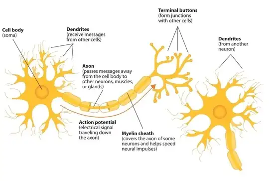

The following diagram illustrates a biological neuron (screenshot of an image from this book).

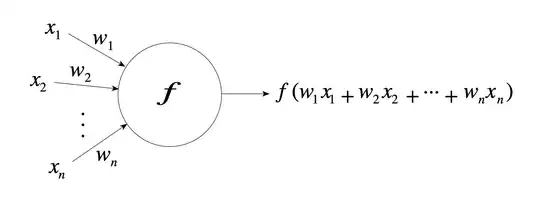

The following one illustrates a typical artificial neuron of an ANN (screenshot of figure 1.14 of this book).
