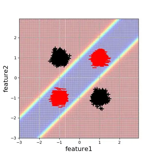

I am working on a simple 2D XOR-like classification example to understand the effects of neural network initialization better. Here's a visualisation of the data and the desired decision boundary: enter image description here
Each blob consists of 5000 data points. The minimal complexity neural network to solve this problem is a one-hidden layer network with 2 hidden neurons. Since this architecture has the minimum number of parameters possible to solve this problem (with a NN) I would naively expect that this is also the easiest to optimise. However, this is not the case.
