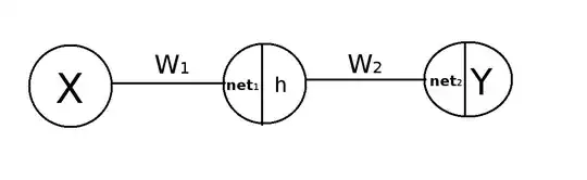

I have computed the forward and backward passes of the following simple neural network, with one input, hidden, and output neurons.
Here are my computations of the forward pass.
\begin{align} net_1 &= xw_{1}+b \\ h &= \sigma (net_1) \\ net_2 &= hw_{2}+b \\ {y}' &= \sigma (net_2), \end{align}
where $\sigma = \frac{1}{1 + e^{-x}}$ (sigmoid) and $ L=\frac{1}{2}\sum(y-{y}')^{2} $
Here are my computations of backpropagation.
\begin{align} \frac{\partial L}{\partial w_{2}} &=\frac{\partial net_2}{\partial w_2}\frac{\partial {y}' }{\partial net_2}\frac{\partial L }{\partial {y}'} \\ \frac{\partial L}{\partial w_{1}} &= \frac{\partial net_1}{\partial w_{1}} \frac{\partial h}{\partial net_1}\frac{\partial net_2}{\partial h}\frac{\partial {y}' }{\partial net_2}\frac{\partial L }{\partial {y}'} \end{align} where \begin{align} \frac{\partial L }{\partial {y}'} & =\frac{\partial (\frac{1}{2}\sum(y-{y}')^{2})}{\partial {y}'}=({y}'-y) \\ \frac{\partial {y}' }{\partial net_2} &={y}'(1-{y}')\\ \frac{\partial net_2}{\partial w_2} &= \frac{\partial(hw_{2}+b) }{\partial w_2}=h \\ \frac{\partial net_2}{\partial h} &=\frac{\partial (hw_{2}+b) }{\partial h}=w_2 \\ \frac{\partial h}{\partial net_1} & =h(1-h) \\ \frac{\partial net_1}{\partial w_{1}} &= \frac{\partial(xw_{1}+b) }{\partial w_1}=x \end{align}
The gradients can be written as
\begin{align} \frac{\partial L }{\partial w_2 } &=h\times {y}'(1-{y}')\times ({y}'-y) \\ \frac{\partial L}{\partial w_{1}} &=x\times h(1-h)\times w_2 \times {y}'(1-{y}')\times ({y}'-y) \end{align}
The weight update is
\begin{align} w_{i}^{t+1} \leftarrow w_{i}^{t}-\alpha \frac{\partial L}{\partial w_{i}} \end{align}
Are my computations correct?

One important point I missed in first review: error is a summatory, its derivative is also a summatory.
About offsets "b": usually they are different in each cell (if not fixed to some value, as 0). Thus, replace them by b1 and b2. Moreover, they should be optimized in the same way that the weights.
